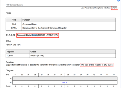

对于采用DMA方式,  单次传输可以设定1024字节或以上么?  从下图规格说明为512
10,873 Views
danielmartynek
Hi @龙开云,
This just specifies how much data can be written there in the burst mode.
But the LPSPI module as well as the RTD driver support longer transfers.

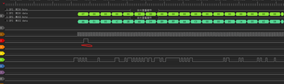

龙开云
图片为全0的情况下,第一个字节也是0x7
10,670 Views

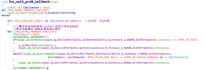

龙开云
使用如下函数进行填充时,是否需要等待,主机端才能读取。
10,634 Views
danielmartynek
The function must be called before the master starts the transfer.
Do you use the Lpspi_Ip_GetStatus() to check the transfer?
Does the transfer completed successfully?
10,541 Views

除了首字节为0x7外;   还出现数据master发送时接收不全的问题,前面的几个数据丢失,但是逻辑分析抓到SPI线的数据是正常的;
目前发现速率在100KHz较为稳定,500KHz以上就比较容易出现问题。

danielmartynek
Hi @龙开云,
What is in the Spi1TxBuffer?
Why do you call the AsyncTransfer() in a while loop?
Also, you cancel the transfer if the GetStatus() function returns other status that IDLE.
You should simply call the AsyncTransfer() once and then poll the GetStatus() function until the transfer is completed, and you have to make sure the AsyncTransfer() function is called before the Master starts the transfer.
Please share the project?

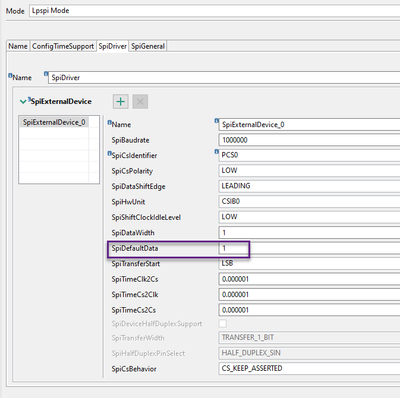

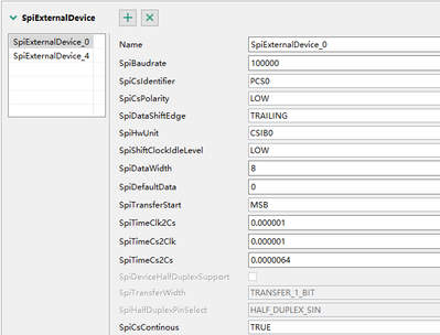

Is the pointer to Spi1TxBuffer 0x00 (NULL) or is the pointer valid and the content of the buffer is 0x00.
Because if the pointer is NULL, the driver sends the SpiDefaultData.
10,020 Views
龙开云
SPI指向的buff数据内容为0,不是指向空NULL。
SpiDefaultData默认设置也为0;

It really requires some debugging on your side.
For example, you can use a GPIO to see when the transfer starts and ends.
Use another communication interface to send the state of the LPSPI TX FIFO.
Also, as I mentioned, there are issues in the code you posted, like you cancel the transfer if the function does not return SUCCESS. You disable the interrupt before the code reads the status of the previous transfer in a while loop etc.
I would recommend simplifying the project, and using at least the GPIOs.
I guess there must be some data left in the TX FIFO from a previous transfer when the current transfer starts.
9,964 Views
龙开云
如下是通过IO检测并装载数据,在装载数据前关闭中断,然后判断SPI是否空闲,之后再装载数据;
最后再开启中断。
请帮忙审核下这样的处理有何不妥之处,如何优化,感谢!
我们通过别的方式再查查。
