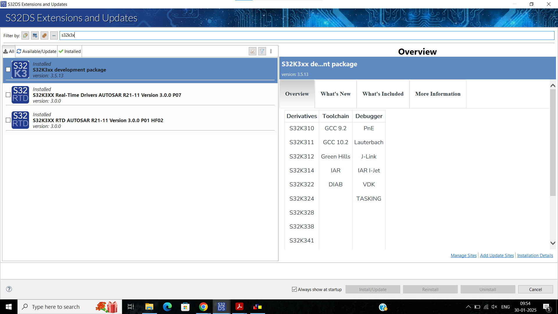

i'm creating Library project (shared library). but there 2 problem i'm facing.
1. only s32kxx is showing during MCU selection but my requirment is s32k324.
2. SDK is not showing during SDK selection.
check in screenshots.
3,240 Views
semiconductor_user
already i installed "S32K3xx development package": you can see in screenshot. then also it's not invisible during library project creation.

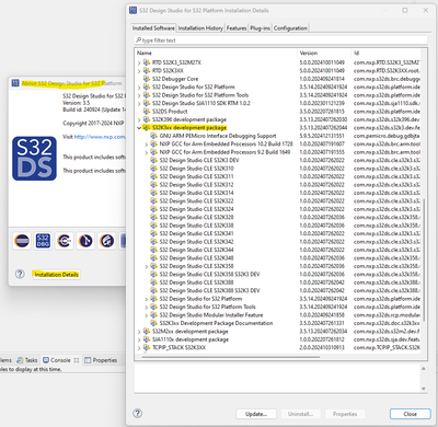

Hello @semiconductor_user ,
Since you are not seeing MCUs and SDK, it looks like RTD has not been installed successfully. In your case, it's necessary to follow SW32K3_RTD_R21-11_3.0.0_P07_D2306_ReleaseNotes.pdf.
Please check Help / About S32 Design .... You should see list like that:
Re-install might be a solution.
I reviewed this case once again and I guess I got it.
If you create a Library project, there's only M7 core, which all S32K3s have. RTD can't be attached. Technically, library project is only set of .o files.
You shall create an Application Project to be able to select MCU and attach RTD/SDK.
