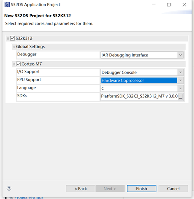

Hello, for functional safety reasons, I need to use IAR to generate compilation files, so I followed the tutorial below to set up the project:
HOWTO-Export-S32DS-Project-to-IAR-EW-S32K14x-S32K11x/ta-p/ 1122428
 The project configuration is as follows:

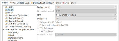

  Then I added the FreeRTOS component and kept the default settings, but I got a compilation error:#error This port can only be used when the project options are configured to enable hardware floating point support.
How can I solve this?

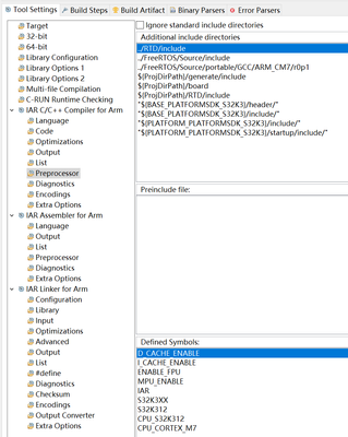

Freertos component package missing IAR portable, in the project to change GCC to IAR file.
2,118 Views
Misaki996
1,960 Views
Faith-Herio
When replaced with an IAR file, compilation fails

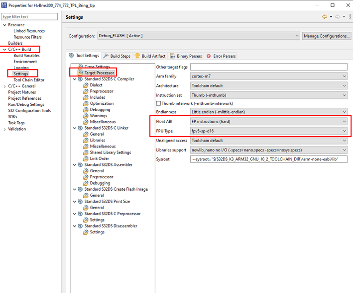

Ok, go to the project properties and enable it:
Peter

S32DS version: 3.5.8
SDK version: 3.0P07
FreeRTOS component version: SW32K3_FreeRTOS_10_5_1_UOS_3_1_0
IAR Embedded Workbench for Eclipse version: 4.2.0
IAR version: 9.20.3.326/W64 for ARM Functional Safety
The compilation configuration is as follows:
