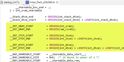

Similar issues are usually caused by wrong or missing SRAM initialization. It is mandatory to initialize the SRAM as described in the S32K3 reference manual:
You can find initialization code in startup_cm7.s:
And the addresses are defined in linker file:
When the code crashes, you can check the SRAM content. If your debugger shows something like ‘XX‘ or ‘??’ instead of valid data, it’s caused by this SRAM initialization. You need to ensure that whole SRAM is initialized appropriately.
If you have bootloader and application or multicore application, you need to decide who and when will initialize the SRAM.

Does the generic linker (linker_flash_s32k324.ld) work for you? This does not reserve SRAM space for core 1:
MEMORY
    int_pflash              : ORIGIN = 0x00400000, LENGTH = 0x003D4000    /* 4096KB - 176KB (sBAF + HSE)*/
    int_dflash              : ORIGIN = 0x10000000, LENGTH = 0x00020000    /* 128KB */
    int_itcm                : ORIGIN = 0x00000000, LENGTH = 0x00008000    /* 32KB */
    int_dtcm                : ORIGIN = 0x20000000, LENGTH = 0x0000F000    /* 60KB */
    int_stack_dtcm          : ORIGIN = 0x2000F000, LENGTH = 0x00001000    /* 4KB */
    int_sram                : ORIGIN = 0x20400000, LENGTH = 0x0002FF00    /* 192KB, needs to include int_sram_fls_rsv */
    int_sram_fls_rsv        : ORIGIN = 0x2042FF00, LENGTH = 0x00000100
    int_sram_no_cacheable   : ORIGIN = 0x20430000, LENGTH = 0x0000FF00    /* 64KB, needs to include int_sram_results  */
    int_sram_results        : ORIGIN = 0x2043FF00, LENGTH = 0x00000100
    int_sram_shareable      : ORIGIN = 0x20440000, LENGTH = 0x00004000    /* 16KB */
    ram_rsvd2               : ORIGIN = 0x20444000, LENGTH = 0             /* End of SRAM */
Note that, ITCM and DTCM do not get extended, as these are local to each core.
I would try to link against this file instead of the C0, C1. It should be in the same eclipse/plugins/Platform_<version>/build_files/<compiler>/ as the c0 and c1 variants.
As for the MPU, It may be a good idea to disable this before configuration as this will prevent issues/faults during configuration itself. The only requirement to write these registers is privileged run mode (which is the default unless you are manually switching to user mode).
