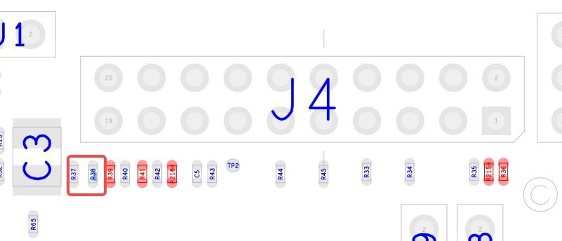

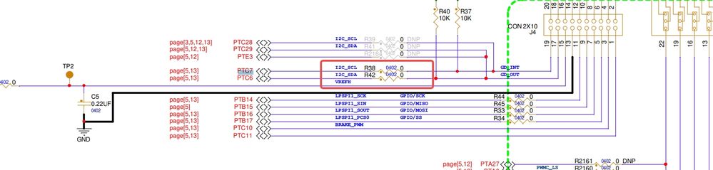

after initialize I2C,Logic analyzer measurement SCL and SDA are high,
SCL uses PTC7 pin
SDA uses PTC6 pin
 SCL, SDA lines have  pull-up resistorsimg_v3_02ij_72d3e22e-090d-40ec-b11e-98c5ed01d5ag.jpgimg_v3_02ij_9501869c-3a21-49a8-989d-f4d088a6716g.jpg

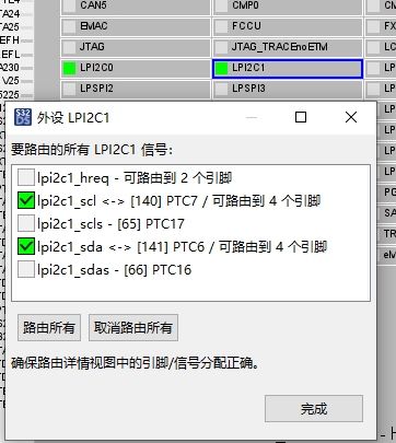

bubububu
It is configured according to the diagram aboveimg_v3_02ij_6cf92420-ea56-477d-8c01-ee7657a0925g.jpgimg_v3_02ij_8695aeae-d24a-4d90-a6b3-845678cdacdg.jpg
1,478 Views
danielmartynek
Please check the MSCR registers in the register view.

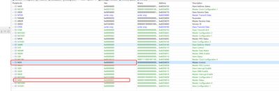

->After the initialization of i2c, MS/CR register state,MSR->BBF bit is 1

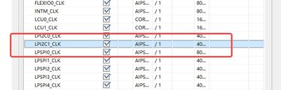

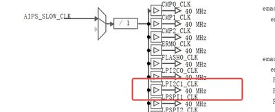

The i2c clock configuration is as follows
