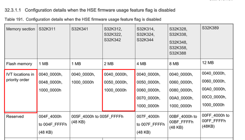

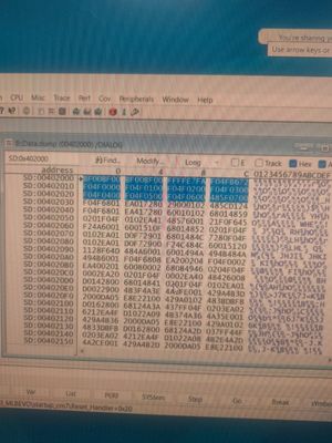

We observed an issue where the software is not reaching the main function.after debugging, we found that the rest handler points to a different address.we have not modified the linker and startup file provide in the package.

Could you please explain the issue in more details?
the IVT can be located only at these addresses. Check the IVT for correct application boot address.
This will tell you where the program will start.
best regards,
