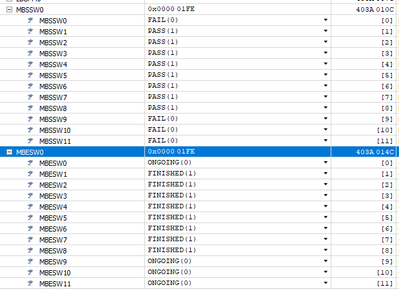

I have problem with BIST configuration.
Processor S32K322, SAF version:  *   SW Version           : 1.0.4 *   Build Version        : S32_SAF_1_0_4_2023122
1. LBIST expected value is:
LB_MISRELSW0 = 0x73D0 53B5
LB_MISREHSW0 = 0x253B 0C27
Which corresponds to the value from file „Bist_SpecificTables_S32K3XX.c”
Value of this register after Bist_Run(BIST_SAFETYBOOT_CFG):
LB_MISRRLSW0 = 0x307A 7C25
LB_MISRRHSW0 = 0x15E4 11A4
Why value which is readed is equal for expected value for S32k342? Because this mean that LBIST_Test is fail.
After executed function: Bist_GetExecStatus() after Bist_Run() i got value BIST_INTEGRITY_FAIL
  1. MBIST configuration.
MBIST test also too have a fail.  Because expected value is:  0x0000 01F0. This value was read from: SAFETYBASE_REG_READ32(BIST_STCU_MB_END_REG(0U));, file Bist_General_S32K3XX.c line 222.
Value of MBIST after Bist_Run: 0x0000 01FE

I have got answer from SAF team.
this is known bug.
Fix will be in SAF K3 1.0.5 released on March 2nd week.
