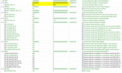

AKV
This is after reset MC_RGM registers value
