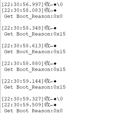

Hi NXP,
     In S32k358 ,I start from LpuartFlexio_Uart_Ip_Example_S32K358 ,
build download and power on reset ,it boot  5 times  automatically,(normally boot only once)
How can i deal with this,Thanks !

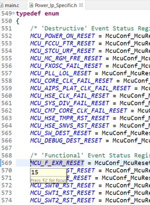

Mcu_ResetType boot_reason = MCU_NO_RESET_REASON;
boot_reason = Mcu_GetResetReason();
if((MCU_NO_RESET_REASON != boot_reason))
Bootloader_DebugPrint("\n Get Boot_Reason:0x%d\n",boot_reason);

Hi @jimmy623,
The MC_RGM[FES] register points to an external reset.
Check the SBC or other devices that are connected to reset_b of the MCU on the PCB.

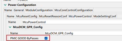

jimmy623
Hi  danielmartynek,
     In RM, mcu/pmic handshake by using PGOOD ,
If PGOOD assertion does not arrive within the configured time, POR WDOG will issue a reset to the MCU.
Can you show me how to enable PGOOD function in fs26.
Thanks!
