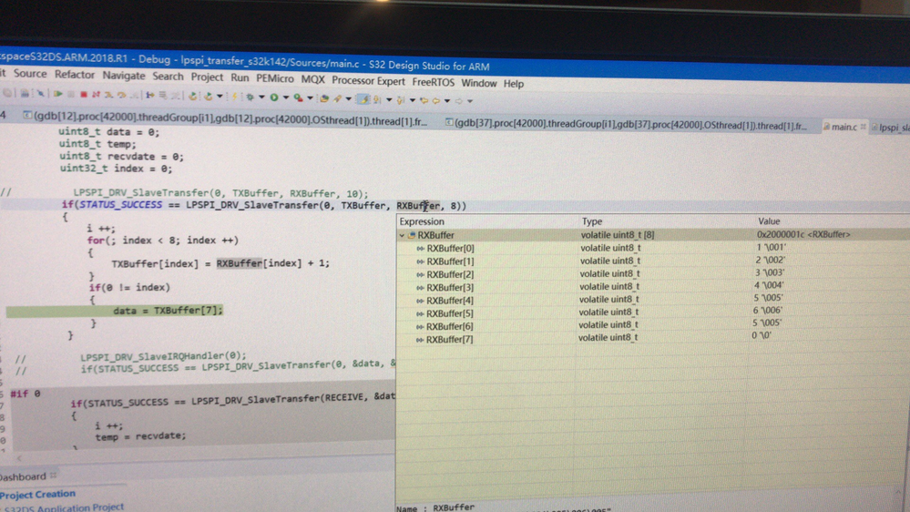

I used master S32k144 sent uint8_t TXBuffer[8] = {0,1,2,3,4,5,6,7};
if(STATUS_SUCCESS == LPSPI_DRV_MasterTransfer(0, TXBuffer, RXBuffer, 8))
to slave S32k142: uint8_t RXBuffer[8] = {0};
if(STATUS_SUCCESS == LPSPI_DRV_SlaveTransfer(0, TXBuffer, RXBuffer, 8))
but the sequence of data in RXBuffer[8] is wrong,as follow, the sequence also changed not surely,sometimes it's {1,2,3,4,5,6,7,0},or {4,5,6,7,0,1,2,3},or {6,7,0,1,2,3,4,5} and so on.
 I check the clock polarity, direction of the 144 and 142 both are clock active high and lsb first. So how can I get the correct sequence of data in RXBuffer[8] as the sequence of data in TXBuffer[8] of master S32K144 sent. Is there some SDK API need to be called.Thank you very much.

First of all, thank you for your patience. I have tried to code follow your advise as above.The code as follow:
master S32k144:
   uint32_t nbytes = 0;
   LPSPI_DRV_MasterGetTransferStatus(0, &nbytes);
   while( 8 != nbytes )
   OSIF_TimeDelay( 1 );
The nbytes of LPSPI_DRV_SlaveGetTransferStatus equal 8, it seem transfered all the 8 datas sucessfully.
slave S32k142:
status_t sts = LPSPI_DRV_SlaveTransfer(0, TXBuffer, RXBuffer, 8);
if(STATUS_SUCCESS == sts)
   uint32_t nbytes;
   LPSPI_DRV_SlaveGetTransferStatus(0, &nbytes);
   if(8 == nbytes)
      for(; index < 8; index ++)
         TXBuffer0[index] = RXBuffer[index];
OSIF_TimeDelay(1);
The nbytes of LPSPI_DRV_SlaveGetTransferStatus always equal 4.I found the description of LPSPI_DRV_SlaveGetTransferStatus() in the SDK documentation is:
So, it's bytesRemained dosn't express the data received sucessfully.

Thank you remind,I found master's transfer frequency was too fast. When I make it slow,the slave receive data is ok.By the way,what's the maximum bytes of buffer can master send once a time.
