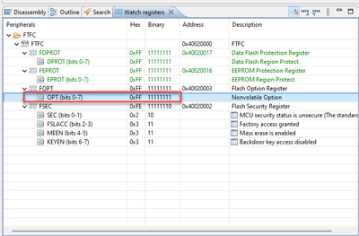

I got a problem recently, when I use cyclone to program S32K144, after that, the MCU can not work. then I download the elf file, try to debug,  I found the data in address range 0x400-0x40f are not correct, they are all become 0, after program again, the data in address range 0x400-0x40f recovery normal, ECU can work normally, is there any one meet this problem?

I am using S32_SDK_S32K1xx_RTM_4.0.2 package, I have found some other information when follow the below steps:
1. erase all the chip.
2. flash S19 file with cyclone,(the data in range [0x400,0x40F] is   FF FF FF FF FF FF FF FF  FF FF FF FF FE 7F FF FF)
3. power off->power on, read the address range [0x400,0x40F], result is  00 00 00 00 00 00 00 00 00 00 00 00 00 00 00 00
4. modified the 0x40D(FTFC_FOPT) from 0x7F to 0xFF.
5. repeat step 1 to step 3, the MCU run normally.

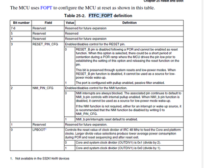

the default FTFC_FOPT value  is defined as 0x7F in startup_S32K144.S, I checked the FOPT definition in S32K-RM, the bit4-bit7 are all reserved, I think the high four bits should not affect the programming, I don't know why 0x7F will cause the failure.

The FOPT[1] and FOPT[7] are meaningful only for initial version of S32K144 silicon (i.e. 0N77P) which has already been obsolete. For the newer S32K1X versions, they don't have a specific meaning. Reserved bits can be set to ‘1’.

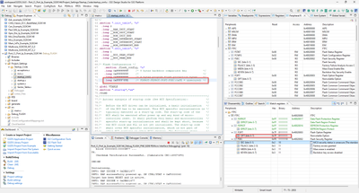

I do not think the reserved bits are the issue. You mentioned you programmed the flash config as 0xFFFF7FFF, which means that the FSEC register is 0xFF = secured.
You are securing the MCU, and unsecuring by doing a mass erase when trying to connect again.
The default value for the startup file is 0xFFFF7FFE; (0xFE = unsecured).
I've tested this configuration, and I can connect without issues, although I am debugging through the OpenSDA interface (functionality should be the same). I've tested both 0x7F & 0xFF and connection is the same. Try value 0xFFFF7FFE instead.

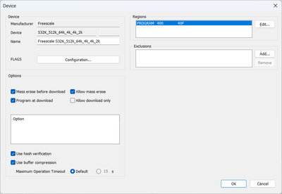

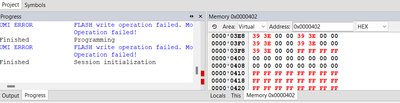

 I used 0xFFFF7FFE instead, not 0xFFFF7FFF, and my program tool is WinIDEA, I configured not to skip 400-40F address, and active mass erase before download.
the programming process will failed at 400-40F address, the 16 bytes all become 0x00, only the address before 0x400 were programmed successfully.
