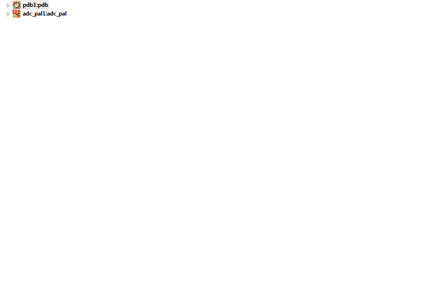

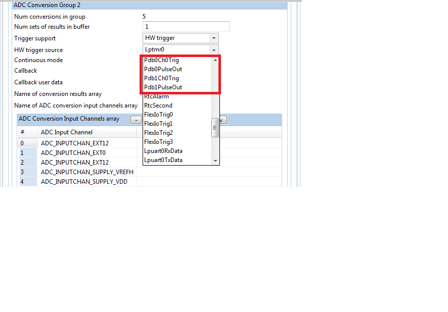

How about using ADC_PAL (adcpal1:adc_pal) with PDB as hardware trigger? May I know how the configuration should be?
Do you have sample code?
Is that any advantage by using PDB as harware triggered as compared with LPTMR in ADC_PAL?
ADC_PAL having back to back mode? I found if drag in PDB component library, the ADC_PAL icon will shows "conflict" sign as below.
