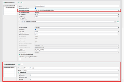

I am not able to assign SpiBaudrateConfig_0 to SpiBaudrateConfigRef in Lpspi Driver.
IDE : S32DS 3.5.13.
RTD : R22_11 V4.0.0.
How do I set the path of SpiBaudrateConfig_0 in SpiBaudrateConfigRef?

Apparently, only the MCAL Spi component generates a valid SpiBaudRateConfigRef value. I did not notice this since I was basing the project in MCAL and not IP:
I think this is not intended, so for now, either configure the SPI component without the "UseBaudrateConfig" parameter or with the MCAL component to generate the reference. I will ask internally to see if this is expected behavior.

I've confirmed with the internal team, and this is a bug. It is planned to be fixed in the next RTD release.
