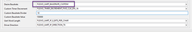

I am working on Flexio UART and the example works fine.
Now I am configuring the same thing in my project, but got different result.

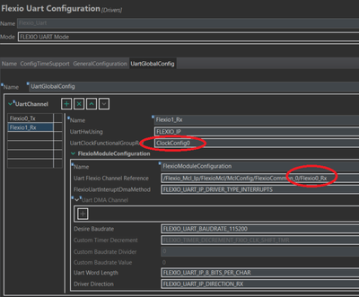

1. In the example, the Flexio Uart Configuration is like this:
In my project, the same config is like this:
Do the differences in the red circles matter?

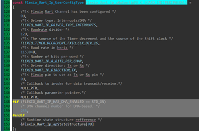

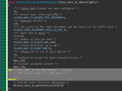

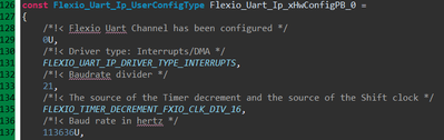

2. baud rate: In the config tool, both the example and my project are set as 115200, but in the code generated, they are different:
This is what's in the example. The divider is 12 and baud rate is 115384.
But in my project, the divider is 20 and the baud rate is 119047.
Why they different while the values are the same in the configuration tool?
3. In the example, the clock source is FRXC and Flexio clock is 48MHz. In my project the clock is PLL and the Flexio clock is 80MHz.  Is the clock difference causing the baud rate values being different as above point #2? If so, how to set the baud rate as 115200 in my project.
Right now, I am able to receive UART messages from MCU, but all are not correct symbols. I tried different baud rates in my PC to receive the UART message from MCU, all can receive messages, but no one receives correct symbols from MCU.  According to the above three differences compared to the Uart example, what might go wrong in my project?
Thanks!
Crane

Hi Crane,

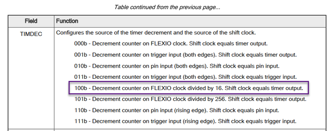

There is this custom option:
Table 129 uses division ratio of 16.

cranes
Hi Daniel,
Tried different settings that are close to 115200, still receives unrecognized symbols. The clock is the only difference from the example. Any other settings I might missed?
Thanks!
Crane
(108695 in code)
(113636 in code)
(119074 in code)

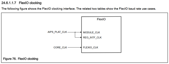

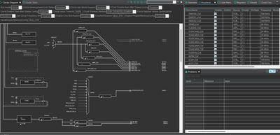

Can you please specify the MCU and the system clock configuration you use?
I'm asking because the FlexIO functional clock is the CORE_CLK.
And it is recommended to use one of the Clocking use case examples (RM, Section 24.7.2).
There is just on option that has CORE_CLK = 80 MHz (Option F).
Do you use Option F or your own configuration?
If you change one clock in an example, you have to change all the clocsk accordingly.

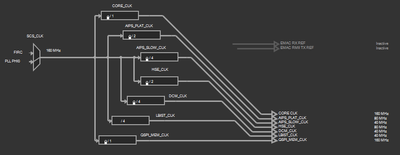

I am using S32K344 at 160MHz core clock and Flexio clock at 80MHz. I am not sure I am using Option F or not. How to verify?
The clock config is like this:
What do you mean "If you change one clock in an example, you have to change all the clock accordingly"? I am adding UART to an existing project. So I take an Uart example from RTD and make it work in my setup. Then copy all the config in the example to the existing project except the clock configuration. I need to keep the clock configuration in that project.
Thanks!
Crane
4,396 Views
danielmartynek
Hi @cranes,
You use the Option A - High Performance mode (CORE_CLK @ 160 MHz) (Section 24.7.2.5) now.
The clock configuration is correct.
However, previously you mentioned that the FlexIO is clocked by 80MHz.
Which meant the CORE_CLK was 80MHz.
The dividers ratios between the clocks (such as the AIPS_PLAT_CLK and CORE_CLK) must be kept.
For example, in Option A, CORE_CLK = 160MHz, AIPS_PLAT_CLK = 80MHz.
If you change CORE_CLK to 80MHz, AIPS_PLAT_CLK must be set to 40MHz and so on.
But it is recommended to use just the Options from the RM without any modification.

danielmartynek
Hi Crane,
The S32K3xx FlexIO works dirrectly with the CORE_CLK.
There is no option to change it.
BR, Daniel

Please have a look at the calculations in the RM, rev.7:
Table 128. FlexIO baud rate calculation (FlexIO.TIMCFGn[TIMDEC] = 101b)
Table 129. FlexIO baud rate calculation (FlexIO.TIMCFGn[TIMDEC] = 100b)
