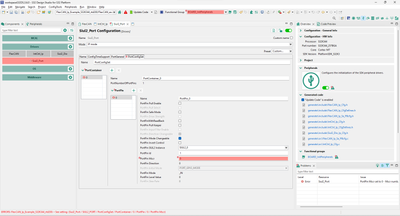

Hi, Sirs
I am trying to run the example you provided, to communicate between CAN board and CAN tool: Example S32K344 FlexCAN_Ip TX/RX/EnhanceRXFIFO test S32DS3.4 RTD200 - NXP Community
But I am getting the error below when configuring with Tool
Error: Mscr was not configured in Pin tool
1,107 Views
PetrS
example was done in S32DS3.4 and RTD200, so you can have issues importing into S32DS3.5 and newer RTD if have any.
Anyway for an error you have, use MSCR number from pins used in PINs tool.
For example for some GPIO pin
BR, Petr

Voledi
thanks for your reply,
i have solved the above error problem when setting Mscr=27 and Mscr=28 for PTA27 and PTA28
