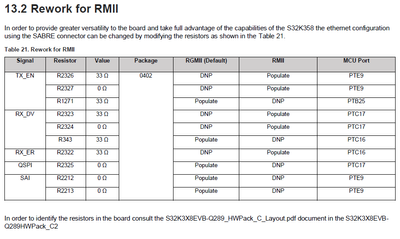

I was going through the hardware user manual and came across the section "rework for rmii"
As per this table , i made the necessary changes in the board.

Hello @ssattva1 ,
I think that it is correct.
Default pin mapping of example lwip_baremetal_s32k358 is RGMII, but GMAC is set to RMII. That's why it works without changes.
If you do RMII rework, you should change GMAC's pin mapping as well.

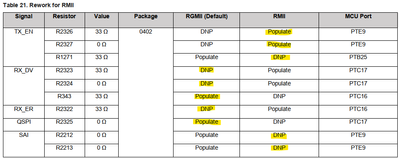

I double checked pin mapping of example lwip_baremetal_s32k358 together with schematics of S32K3X8EVB-Q289 and ADTJA1101.
In my opinion:
  • No SW changes are necessary - RX_ER is not assigned in Gmac to pins, RX_DV (PTC16) and TX_EN (PTE9) are assigned to pins
  • HW changes shall look like that, i.e. the highlights are valid:
Please check it out.
Pavel

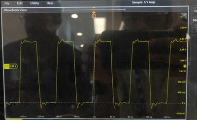

I am flashing this configuration in a board with no rework for rmii . I probe the txctl and tx_en signals , which are at PTB25 and PTE9 respectively. I observed that TXCTL goes high whenever i transmit a frame , but when i observed tx_en from PTE9 I obsrved this
A periodic pulse of period 80ns .
What I infer is , tx_ctl essentially acts as the tx enable signal. Also in schematic Tx_ctl line is populated and tx_en from PTE9 is DNP. Then what is this periodic signal from PTE9 that I am observing.
