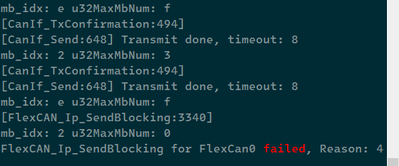

Hi NXP teams:
I configure two Can interfaces on the S32K344 EVB(RTD4.0, EBTresos to config), Can0 sends and receives normally, but Can4 can only receive but not send. My configuration is as follows:
FlexCan0:
FD enabled, 2 HRH (one receiving Standard ID, one receiving Extend ID, respectively using 64Byte RamBlock0/1), 1 HTH (64Byte RamBlock2), 3 HOH HW count are 1, enable RamBlock, not enable TTController, RxFiFo.
FlexCan4:
FD enabled, 2 HRH (one receiving Standard ID, one receiving Extended ID, using Unified 64Byte RamBlock), 1 HTH (Unified 64Byte RamBlock), the HW count of 3 HOHs is 1, RamBlock is enabled on, not enable TTController, RxFiFo.
Polling is used for sending, Interrupt is used for receiving, the normal rate is 500K, FD: 2M, and the sampling rate is 80%. for both Can instance.
HOH configure:
0. ->Receive Std ID Frame for Can0, HW Count: 1
1.  ->Receive Ext ID Frame for Can0, HW Count: 1
2. ->Receive Std ID Frame for Can4, HW Count: 1
3. ->Receive Ext ID Frame for Can4, HW Count: 1
4. ->Transmit Mixed ID Frame for Can0, HW Count: 1
5. ->Transmit Mixed ID Frame for Can4, HW Count: 1
Currently Can4 can only receive data, but cannot send it. Using the FlexCan_Ip_SendBlocking function will report an error: FLEXCAN_STATUS_BUFF_OUT_OF_RANGE
I found this error is generated from FlexCan_Ip_SendBlocking->FlexCAN_StartSendData->FlexCAN_IsMbOutOfRange.
The parameter passed to FlexCAN_IsMbOutOfRange is MBIndex: 5, MaxMbNum: 0, so it reported an error when the FlexCAN_IsMbOutOfRange Exit.
My initialization code is as follows. What is the possible cause of this problem and how can I fix it? Thank you!

Hello @baowei_shen,
You passed into wrong the first parameter in this statement:
FlexCAN_Ip_SendBlocking(1, 2, &TestMsgForm, 2U, dummyData, 100);
The first parameter (Flexcan_Ip_u8Instance) must be 4 (FlexCan4) instead of 1 (FlexCan1)
Dan

DanNguyenDuy
Hello @baowei_shen,
I checked the generated files with your configuration.
With CanController_1 (FLEXCAN_4), the .max_num_mb = 3 and u8MbIndex = 2 with HTH
I tested with statement: Can_43_FLEXCAN_Write(Can_43_FLEXCANConf_CanHardwareObject_CanHardwareObject_5, &Can_PduInfo). The  FlexCAN_IsMbOutOfRange() was returned false because the  if (u8MbIndex >= (uint8)u32MaxMbNum) didn't happen (u8MbIndex = 2 and u32MaxMbNum = .max_num_mb = 3).
Please re-check parameters that passed into the Can_43_FLEXCAN_Write() function in your project.

baowei_shen
Hi @DanNguyenDuy :
I'm currently use Can_43_FLEXCANConf_CanHardwareObject_CanHardwareObject_5 as parameter for FlexCAN_Ip_SendBlock, so it is because i use the wrong parameter?
As your method, i should use u8MbIndex:14 for FlexCan0 and u8MbIndex:2 for FlexCan4 pass to FlexCAN_Ip_SendBlock, am i right?
3,155件の閲覧回数
DanNguyenDuy
Hello @baowei_shen,
Yes, correct.
Dan

baowei_shen
Hi @DanNguyenDuy
I edited my code as below:

 and the result is:
If i use the function Can_43_FLEXCAN_Write to send can msg, both FlexCan0/4 works
But when i use FlexCAN_Ip_SendBlocking  to send msg, only FlexCan0 works, even though i used MbIndex:2 for FlexCan4, And you can check the last 2 line in the result pic, when i passed MbIndex:2 to FlexCAN_Ip_SendBlocking, the u32MaxMbNum is not 3 but 0.
Is this a bug or i'm using FlexCAN_Ip_SendBlocking  in the wrong way?

DanNguyenDuy
Hello @baowei_shen,
Dan

baowei_shen
Hi @DanNguyenDuy
Very appreciate your work, I thought should use the CanController ID for parameter.
Thank you very much.
