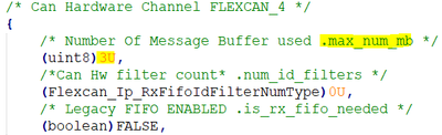

Currently Can4 can only receive data, but cannot send it. Using the FlexCan_Ip_SendBlocking function will report an error: FLEXCAN_STATUS_BUFF_OUT_OF_RANGE
I found this error is generated from FlexCan_Ip_SendBlocking->FlexCAN_StartSendData->FlexCAN_IsMbOutOfRange.
The parameter passed to FlexCAN_IsMbOutOfRange is MBIndex: 5, MaxMbNum: 0, so it reported an error when the FlexCAN_IsMbOutOfRange Exit.

I checked the generated files with your configuration.
With CanController_1 (FLEXCAN_4), the .max_num_mb = 3 and u8MbIndex = 2 with HTH
I tested with statement: Can_43_FLEXCAN_Write(Can_43_FLEXCANConf_CanHardwareObject_CanHardwareObject_5, &Can_PduInfo). The  FlexCAN_IsMbOutOfRange() was returned false because the  if (u8MbIndex >= (uint8)u32MaxMbNum) didn't happen (u8MbIndex = 2 and u32MaxMbNum = .max_num_mb = 3).

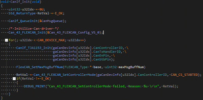

void CanIf_Init(void)
uint32 u32Idx = 0U;
Std_ReturnType RetVal = E_OK;
static uint8 dummyData[8] = {0,1,2,3,4,5,6,7};
static Flexcan_Ip_DataInfoType TestMsgForm = {
.data_length = 8u,
.msg_id_type = FLEXCAN_MSG_ID_EXT,
.is_polling = true,
#if (FLEXCAN_IP_FEATURE_HAS_FD == STD_ON)
.fd_enable = CAN_IF_FD_EN,
.fd_padding = 0xcc,
#endif
.is_remote = false,
CanIf_QueueInit(&CanMsgQueue); /* My own queue, using for restore Can message */
/* Initilize Can driver */
Can_43_FLEXCAN_Init(&Can_43_FLEXCAN_Config_VS_0);
/* Init FlexCan0 Transceiver */
CanIf_TJA1153_Init(0, \
Can_43_FLEXCANConf_CanHardwareObject_CanHardwareObject_4, \
85U, \
84U);
RetVal = Can_43_FLEXCAN_SetControllerMode(Can_43_FLEXCANConf_CanController_CanController_0, CAN_CS_STARTED);
if(RetVal != E_OK)
DEBUG_PRINT("Can_43_FLEXCAN_SetControllerMode for FlexCan0 failed, Reason: %u \r\n", RetVal);
/* Init FlexCan4 Transceiver */
Can_43_FLEXCANConf_CanHardwareObject_CanHardwareObject_5, \
111U, \
109U);
RetVal = Can_43_FLEXCAN_SetControllerMode(Can_43_FLEXCANConf_CanController_CanController_1, CAN_CS_STARTED);
if(RetVal != E_OK)
DEBUG_PRINT("Can_43_FLEXCAN_SetControllerMode for FlexCan4 failed, Reason: %u \r\n", RetVal);
/* Use Can_43_FLEXCAN_Write to send via FlexCan0 */
RetVal = CanIf_Send(0, Can_43_FLEXCANConf_CanHardwareObject_CanHardwareObject_4, &TestMsgForm, 1U, dummyData);
if(E_OK != RetVal)
DEBUG_PRINT("CanIf_Send for FlexCan0 failed, Reason: %u \r\n", RetVal);
/* Use Can_43_FLEXCAN_Write to send via FlexCan4 */
RetVal = CanIf_Send(0, Can_43_FLEXCANConf_CanHardwareObject_CanHardwareObject_5, &TestMsgForm, 2U, dummyData);
if(E_OK != RetVal)
/* Use FlexCAN_Ip_SendBlocking to send via FlexCan0 */
RetVal = FlexCAN_Ip_SendBlocking(0, 14, &TestMsgForm, 2U, dummyData, 100);
if(E_OK != RetVal)
DEBUG_PRINT("FlexCAN_Ip_SendBlocking for FlexCan0 failed, Reason: %u \r\n", RetVal);
/* Use FlexCAN_Ip_SendBlocking to send via FlexCan4 */
RetVal = FlexCAN_Ip_SendBlocking(1, 2, &TestMsgForm, 2U, dummyData, 100);
if(E_OK != RetVal)

 and the result is:
If i use the function Can_43_FLEXCAN_Write to send can msg, both FlexCan0/4 works
But when i use FlexCAN_Ip_SendBlocking  to send msg, only FlexCan0 works, even though i used MbIndex:2 for FlexCan4, And you can check the last 2 line in the result pic, when i passed MbIndex:2 to FlexCAN_Ip_SendBlocking, the u32MaxMbNum is not 3 but 0.
Is this a bug or i'm using FlexCAN_Ip_SendBlocking  in the wrong way?

baowei_shen
Please ignore the FlexCAN_SetMsgBuffNum call in initial function, it's mistake
