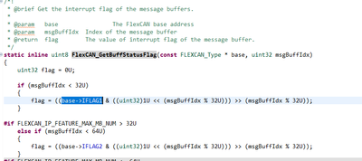

I am still stuck  in situation for receiving CAN messages. Please see the attached screenshots, Even if I am not sending any message still "RStatus" is "FLEXCAN_STATUS_SUCCESS", and when I am sending message from PCAN then also the "RStatus" is "FLEXCAN_STATUS_SUCCESS".
The msgID shows some garbage value.

ashwinibalkwade
Hi @PetrS ,
I tried this but FlexCAN_Ip_GetTransferStatus(INST_VS_0_FLEXCAN_0, RX_MB_IDX) returns "FLEXCAN_STATUS_SUCCESS" every time.
When I debugged the code I found that the below base->IFLAG1 is setting to 0 and hence causing the skipping of while loop.
Can you please help me to know from where is this getting set to 0, I tried debugging but didn't find the exact loophole?

PetrS
share simplified project you are using now, to check how driver's function are used.
