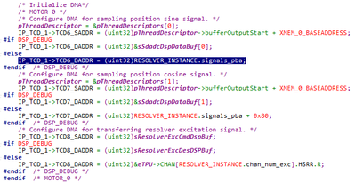

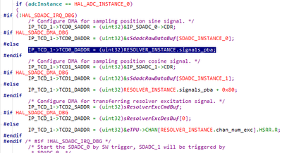

I have a demo(s32k396_dual_mc_v0.8.0.exe) for dual motor control, but I am not sure if it really used DSPSS.
In SDADC initialization(HAL_ADC_SDADC_Init), config DMA trafer data from SDADC to eTPU(shouldn't that be DSPSS?)
In DSPSS initialization(DSP_Init), config DMA trafer data from DSPSS to eTPU.

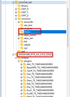

Zhougw
In dual motor demo project, DSPSS is not in RTD directory, And I didn't find it in RTD, is there something I need to download?
