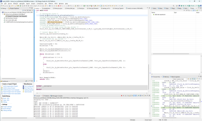

I found out issue here:
is needed just change Clock_Ip_Init(&Clock_Ip_aClockConfig[0]) function instead Clock_Ip_InitClock(&Clock_Ip_aClockConfig[0]) used on example which is "sub function of previous one.
Now is working for  and  you can mark this as SOLVED

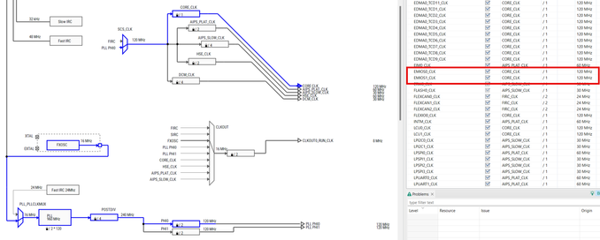

Examples are clocked in the following way:
I hope this information is helpful.

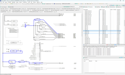

Hi Leo,
I trying this project again and setup clock follow your screenshot but still is there HARDFAULT.

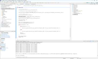

One question: you r screenshot is from what environment-versions? MCU, S32DS.RTD? Because main looks different:
and you can see that EMIOS IP is driving from CORE_CLK.

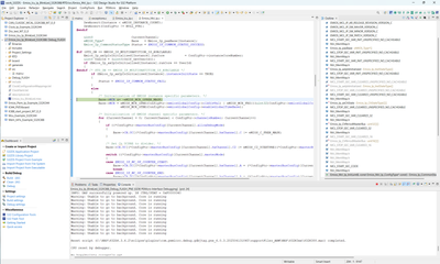

I try to add  Emios_Mcl_Ip_Init function (I not sure if  that really missing) to my main.c:
and here is exact place where code first time try access EMIOS-MCR register and step over this cause HARDFAULT immediately:
