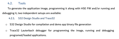

I am running HSE_DEMOAPP_S32K388_0_2_49_0 two examples.
using HSE FW version: HSE_FW_S32K388_0_2_49_0 and board S32K388EVB-Q289
For the S32KXX_demo_app, it's stuck in the infinite loop of WaitandSetFWEnablefeatureflag()
From ReadMe.pdf, it seems like it hasn't loaded the HSE fw.bin pink image.
ReadMe.pdf only provide instruction of how to load fw.bin pink image by Trace32.
1. How can I use S32 Design Studio 3.5 to load the pink image? (it appears the 0x400000 is Read only)
2. What are all of the steps to run the two examples in the demo app package using S32 Design Studio 3.5? (Do you have similar pdf to run the demo using S32DS)

Hi @PaulHu
HSE DEMOAPP is written to be used only with Trace32. It won't work with S32DS debugger. It's explicitly mentioned in the readme file:
 and
The application is controlled by custom menu in Trace32.
If you don't have Trace32, use rather HSE DemoExamples:
https://www.nxp.com/webapp/Download?colCode=S32K3_HSE_DemoExamples
In fact, this is HSE DEMOAPP ported to individual projects which can be used with any debugger.
There's also SW example for HSE firmware installation.
Lukas
