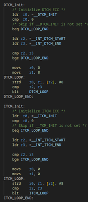

In S32K388 observed DTCM and ITCM ECC errors. Enabling DTCM, ITCM and initialization of ITCM and DTCM memory is in startup code. Also enabled MPU.

Upon POR, ECC must be initialized on all volatile memories. This requires 64-bit writes to initialize the ECC bits prior to reading this memory. This should occur in the startup code (startup_cm7.s) but is dependent on the __DTCM_INIT and __ITCM_INIT symbols being set to 1. (These are set in the linker file)
If you are getting ECC errors, please ensure that this is running as a part of the startup code, and that the address that you are accessing was included in this loop (Between __INT_DTCM_START and __INT_DTCM_END).
