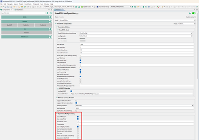

1. You can enable and configure the SMP feature inside the FreeRTOS package from Config Tools:
3. In the latest FreeRTOS package (for RTD 5.0.0), there is an existing example for S32K358 and SMP, FreeRTOS_Toggle_Led_Example_S32K358_SMP. Here is the description:

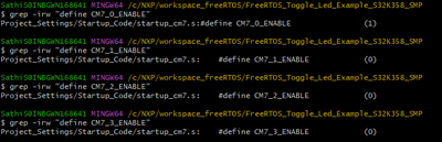

Additionally, I have a few observations:
I noticed that the startup code doesn't seem to enable M7_2.
sathishkumar_sunmugavel_0-1750230555808.pngsathishkumar_sunmugavel_0-1750230555808.png
  • In that case, how is this core supposed to be activated?
  • Since the FreeRTOS kernel is running on the boot core (M7_0), will it be responsible for starting the secondary core?
Sathish.

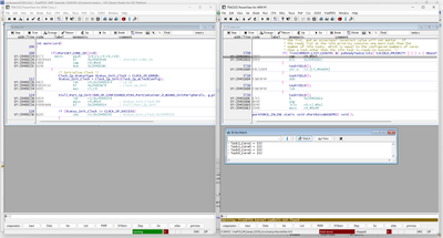

2. If you already have a TRACE32 installation, you can simply open a TRACE32 Arm instance, load the .elf file with the Lauterbach debugger, and run the "run.cmm" script under the debug_t32 folder inside the project's directory.
This should pop two windows, from which you can control the program flow.

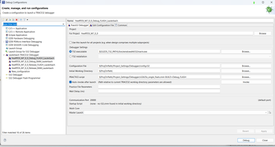

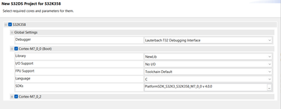

I have installed the TRACE32. If I create a project with Lauterbach T32 Debugging Interface like below,
sathishkumar_sunmugavel_0-1750650754811.pngsathishkumar_sunmugavel_0-1750650754811.png
I am able to see the debug configurations for Lauterbach Debugger.
sathishkumar_sunmugavel_1-1750650844590.pngsathishkumar_sunmugavel_1-1750650844590.png
Is it sufficient to just click debug from this debug configuration? Please share me the steps how to load the .elf and run "run.cmm".
Also, If I open "FreeRTOS_Toggle_Led_Example_S32K358_SMP" project, I don't see any debug configurations for the project. Please let me know how to create the debug configuration or load elf and run 'run.cmm' in this case.
Sathish.

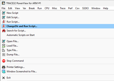

This simply loads the .elf file to the MCU, which is the first step. You can use S32DS as a GUI to flash the board, or use the Lauterbach interface, whichever should be fine.
In the TRACE32 instance, you can select "File -> Load File" and select the file from the "debug" folder.
After loading the .elf file, you can run the script by clicking "File -> ChangeDir and Run Script", then move into the debug_t32 folder and click the run.cmm file.
This should run the configuration (load to RAM, path to elf file, which boot core, multicore ON, etc.) and open up the two windows I've previously shared in the thread.
