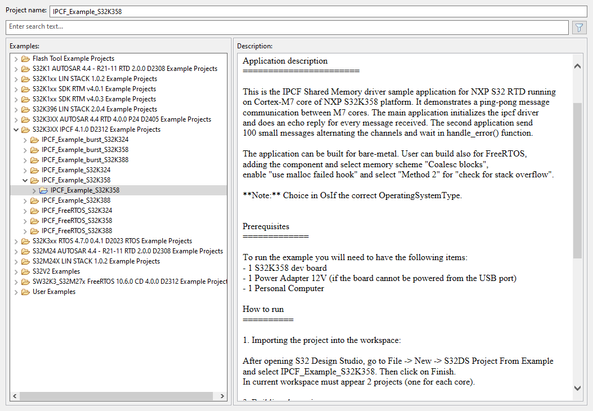

Use Inter-Platform Communication Framework (IPCF)
https://www.nxp.com/design/design-center/software/automotive-software-and-tools/inter-platform-commu...
Which is an extension to the RTD and it is available in the S32K3 Standard Software.
https://www.nxp.com/webapp/swlicensing/sso/downloadSoftware.sp?catid=SW32K3-STDSW-D
Please read the release notes of the SW, it specifies compatible RTD versions.
Once it is installed in S32DS IDE, create a project from example:

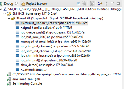

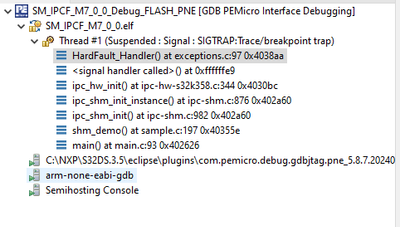

I have reffered the IPCF burst example project and edited my S32K358 Multicore code . I have added the Platform MCAL driver and IPCF middleware driver to both M7_0_0 and M7_0_2 projects. I have made sure that i had he MCU MCAL driver in the M7_0_0 project. I have followed these driver configurations as per the example codes.
Once the programs are flashed, the execution gets interrupted in the IPCF hw instance initialisation. I am getting a hardfualt due to the IPCF interrupt set for core0. I am getting the exact same issue for core2.
When i simply ran the IPCF example given in the examples library, i am getting hard fault error for a different reason. On analysing it, i found out it is something to do queue write and read sizes with the managed/un-managed channels configured for IPCF instances.
Just be clear, i have not made any configurations with respect to the IPCF example and the multicore code. Please find the attached projects and please tell me where and what am i missing.
