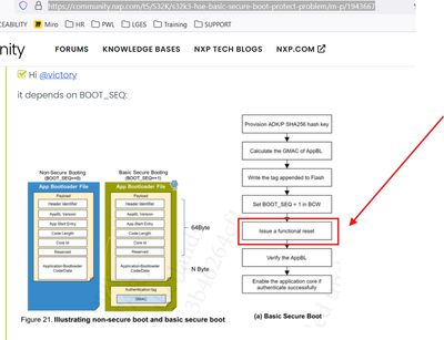

I find out that after configure the SMR, functional reset must be used instead of destructive reset. After changing to functional reset, the HSE Firmware works well.
We can close this topic.

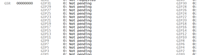

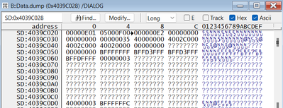

If FSR register remains 0x00000000 even after about 1s after reset, it means that HSE firmware has not been started at all. What can you see in GSR register? Is bit 0 set? And what can you see in HSE GPR register at 0x4039_C028?

Here is the GPR register value
GSR value is 0
