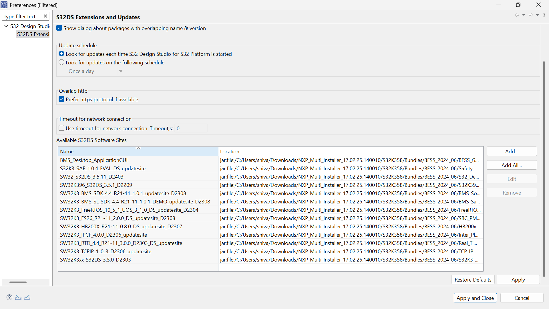

I have downloaded s32DS version 3.5.0 and s32k358 bess_bundle. When i am trying build the project, it is throwing some errors regarding version errors. I have attached the images regarding extenion packs and errors I have installed.

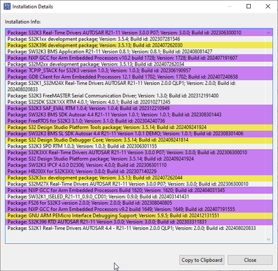

VaneB
Hi @Shivanand
I have compared the packages you have installed with my environment, and I noticed that some of your packages are not up-to-date. To rule out any potential issues caused by this, could you please update the packages I have highlighted in yellow?
Once you have done that, kindly let me know if you observe any changes in the project.

VaneB
Hi @Shivanand
