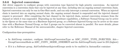

I confirmed that hw normal and hw inject trigger can't be enabled at same ADC hw unit.
ADC driver follow ASR spec:
As description about Inject Conversion in UM that was attached in the package:
So, if you don't want to use SW trigger, you need to use BTCU control mode instead of trigger mode.

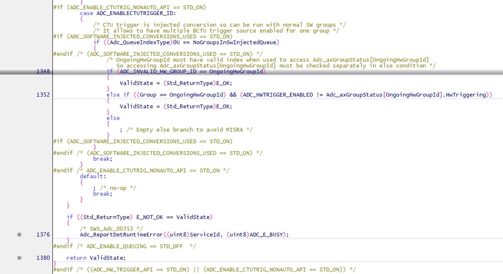

Thank you for your answer. However, I can't get your suggestion to work. As you suggested, I'm using Adc_EnableHardwareTrigger() for the normal hw trigger and Adc_EnableCTUTrigger() for the bctu hw injected trigger. I call Adc_EnableHardwareTrigger() first and then Adc_EnableCTUTrigger(), which once again fails in Adc_ValidateNotBusyEnableHwTrig()... see image. I also tried flipping the order I call the enable hw trigger functions, only the one I call first will start its group conversion.
The if statement ends up in the empty else branch, i.e. ValidState stays E_NOT_OK.
It seems as Adc_axUnitStatus[Unit].OngoingHwGroup is also used for BCTU triggers? And there can only be one hw trigger per adc unit? What am I missing to get your suggestion to work?
When I removed the Adc_ValidateNotBusyEnableHwTrig() check, both groups successfully started conversions, so without this check it seems to work.
Using RTD 2.0.0 but looked at RTD 3.0.0 and the code seems to be the same.
