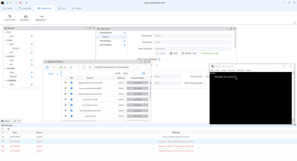

I’m currently using EcuBus Pro and encountered a problem:
“Sequence Tester_1 Error: Device not found.”
I’ve already confirmed that the PCAN interface is working properly and can successfully communicate with the S32K344 over the CAN bus.
Could you please advise how to resolve this issue? Thanks!

I found the reason that i didn't choose the device in sequence.
