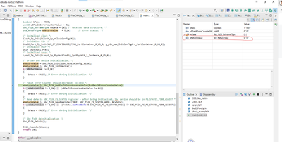

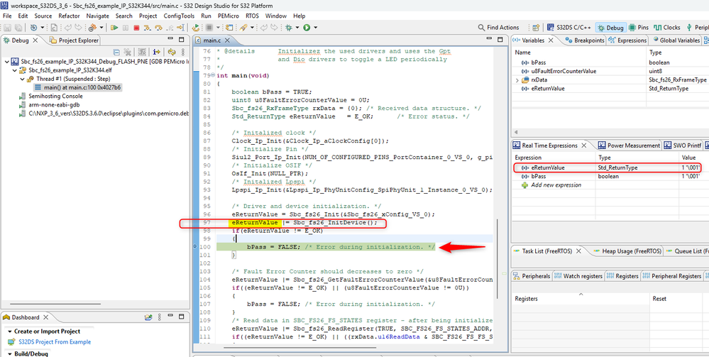

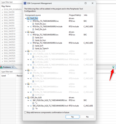

After running the Sbc_fs26_example_IP_S32K344, I found that the result of the function Sbc_fs26_InitDevice() is  eReturnValue = 1 '\001',   which further fulfills the condition in line 98, and that causes /* Error during initialization. */.
The signal that I get when I run the code, however, seems OK
My question is, why doesn't the function Sbc_fs26_InitDevice()  return a value equal to E_OK?

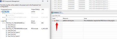

What I noticed when initially loading the example was that the S32DS 3.6 reported a problem, which I successfully solved by adding the suggested files.
Could this be related to an initialization error?

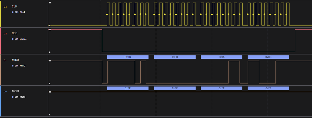

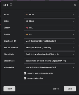

Here are signals on my analyzer
And this is the settings for analyzer

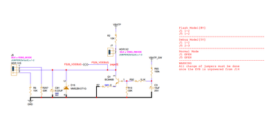

The board we use for example is S32K3X4EVB-T172 with schematic S32K3X4EVB-T172_PackRevB_Schematic. Jumpers are in their default position

Hi, from what I see on your logic analyzer, there is no data out from MOSI pin, it seems that MOSI bus is pulled up all the time, can you please check again your hardware setup?
 I have no problem with the example on my side

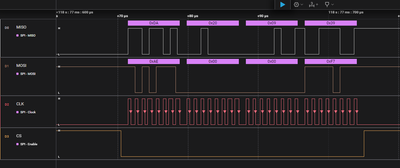

Djuric
Thanks for your reply.
Can you upload a screenshot with signals from your logic analyzer ?
Also, what development board are you using?
Could you show in the datasheet of that development board, which jumper arrangement (operating mode) you set for FS26 ?
