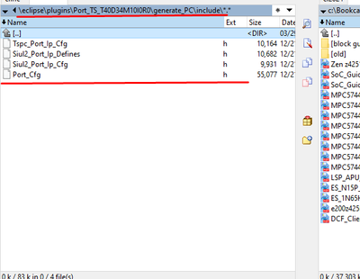

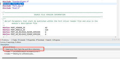

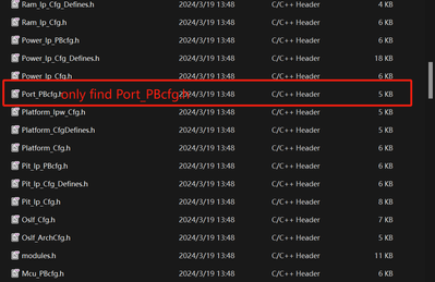

Hello Team:
When I used EB Tresos generated Port model's code,but It not generated Port_cfg.h code ,I can not find file in my computer disk.And there are something wrong .
So I don't know how to solve it.

Port_CFG.h is part of the PORT module of driver.
Check the driver to see if you have it installed:
Peter

I confiured setup the driver ,it located in "generate_PC" directory
but I think the "Port_cfg.h" can be generated by EB Tresos .
Because I has been generated it in other Project ,so I can't understand why EB Tresos can't generate it this time.Is there other way to solve it ?

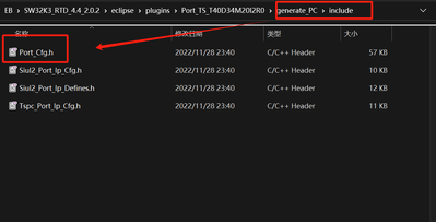

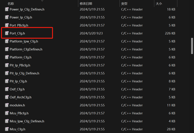

shiqi_seventeen
Thank you Perter
As the before,I carelessly delete  the  generated directory by EB Tresos.So "Port_cfg.h" is also deleted.Last I follow your tips to find it my computer:
Then I think if I click "Generate PC" button,maybe it work.
And it successfully generated in the ouput directory again !
