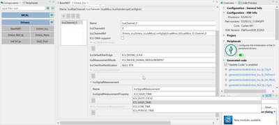

ICU this mining cycle overflow function, is there a routine, is it necessary to enable something at the time of initialization? I added this function but did not enter the callback function when overflow. The overflow mode is a continuous high level given by another pin, connected to the detection pin of the icu with a jumper.

As I can infer from the attached images, you are using ICU Mode set to "Signal Measurement". However, when enabling "IcuOverflowNotification" in this mode, the notification will only be triggered once a measurement completes. Since you are introducing a continuous high-level signal, this notification won't trigger because your ICU is configured to measure on rising edges.
For further details on the ICU Driver and the use of the Icu Overflow Notification, please refer to section 4.99 (Parameter IcuOverflowNotificationApi), in the ICU User Manual. You can find the manual at the following location on your computer:
C:\NXP\S32DS.3.5\S32DS\software\PlatformSDK_S32K3\RTD\Icu_TS_T40D34M50I0R0\doc
Please let me know if you have more doubts.

If my understanding is correct, you want to measure the time of a high or low pulse, therefore you can configure the ICU Mode set as "Signal Measurement" and set "IcuSignalMeasurementProperty" to "ICU HIGH TIME" or "ICU LOW TIME" as shown in the image below:
Please let me know if this helps you.
