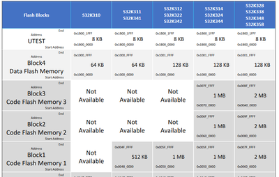

This below macro from C40_Ip_cfg.h file. It shows that size of data flash is 256 KB. In reference manual there is memory map attached it showing 128 KB memory.
/* Data block addresses */
#define FLS_DATA_BLOCK_BASE_ADDR            (0x10000000U)  /*!< the base address of data block */
#define FLS_DATA_BLOCK_END_ADDR             (0x1003FFFFU)  /*!< the end address of data block */
Above image also saying data flash is 128 KB.
So, how much memory I need to consider for data flash memory?

Hello @eiankit,
I'm sorry for the delay.
It should be update in RTD_4.4_S32K3XX_2.0.0.
BR, Daniel

Hi @eiankit,
Thanks for pointing this out.
Let me report that.
