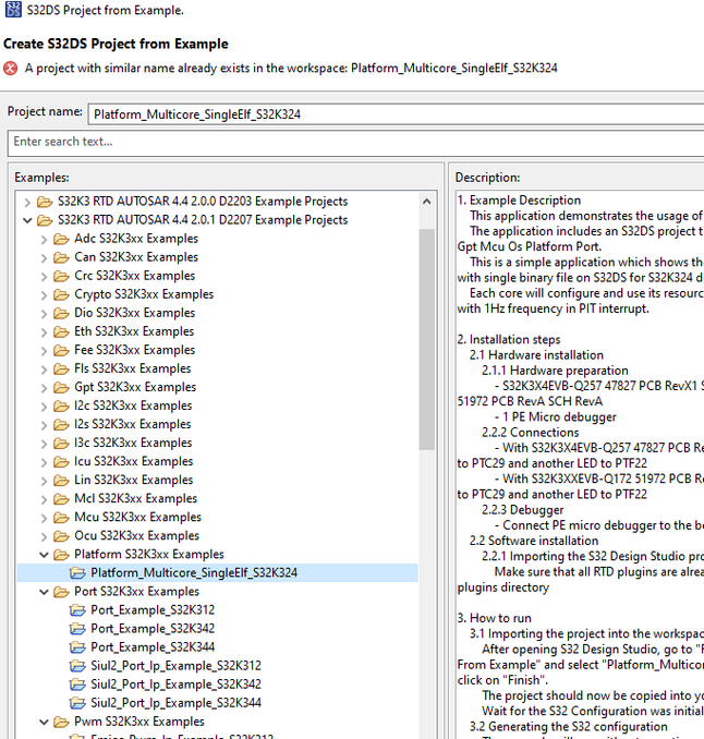

Hello @VecMidOs,
I'm not sure if I understand, but if you have the S32K344 decoupled, you can use the Platform_Multicore_SingleElf_S32K324 RTD example.
It shows how to start the core.

In S32DS 3.4 IDE with RTD 2.0.1 installed, create project from example:
BR, Daniel

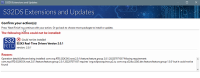

Unfortunately I get this error:
BR,
Milad

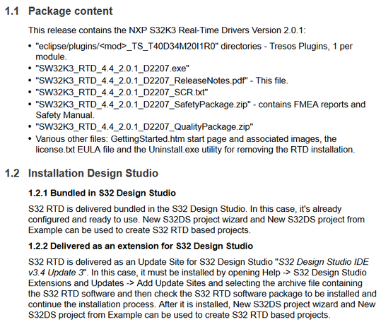

Hello Milad,
The release notes does not list any dependencies:
Is the S32K3xx development package installed?
Do you get the same error when you install the RTD 2.0.0 or 1.0.0 version?
