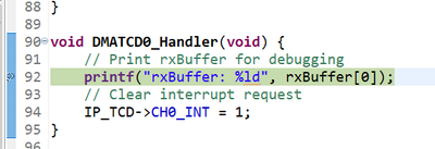

danielmartynek
HI Mateusz,
Thanks for the project.
First, I enabled DMAMUX_0_CH0 at 4028_0000h + 0x3.
IP_DMAMUX_0->CHCFG[3] = 0xAE;
Then I saw that SBE = 1 Source bus error in the TCD0 descriptor.
The TCD0_SADDR register was not configured (checked in the register view)
IP_TCD->TCD0_SADDR = &IP_LPSPI_1->RDR;
Now, it gets to the DMA handler:
在原帖中查看解决方案

danielmartynek
HI Mateusz,
847 次查看

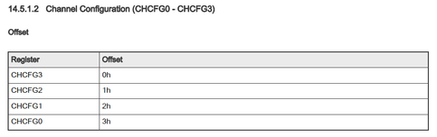

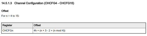

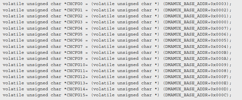

mateusz_swiszcz
Hi, @danielmartynek
Why does CHCFG[3] works and CHCFG[0] not when I'm using TCD0 and Channel 0 of DMA? How can i match numbers of CHCFG[n], TCDn, CHn in case of other instances of SPI or other peripheries?
843 次查看
danielmartynek
Hi @mateusz_swiszcz,
Here is the offset of the registers:
900 次查看
