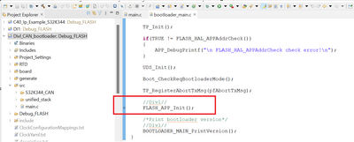

Hi NXP team, I am doing bootloader on S32K344, base on : https://community.nxp.com/t5/S32K-Knowledge-Base/Unified-bootloader-Demo/ta-p/1423099
Using S32DS 3.6 + RTD5.0.0, I modified some things on "S32K344_CAN_Bootloader_RTD2d0" so it can be available on RTD5.0.0, When I build there is no error, but when I run debug, set break point at "FLASH_APP_Init();"
then I "step over" this function then the program reports the following error: Break at address "0x0" with no debug information available, or outside of program code.
Can you take a look and point out the risk of causing the error (attachment file below)

Hi @Voledi.,
I’m sorry to say that Unified bootloader shared on the community is only unofficial demo provided AS IS with no guarantees and no support. Currently we do not have resources to support this demo. We apologize for any inconvenience.
That said, I suggest stepping into the function (instead of stepping over) and locating the line which triggers the hard fault.
