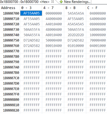

Hi @petervlna ,
Below image id the data available in 0x1B000700, so i need to copy my DCF record in 0x1B000770?
Can you give me an example for DCF Records, to enable Lockstep
Is there any document for DCF details?
タグ(2)
4,738件の閲覧回数
petervlna
Yes, that is correct.

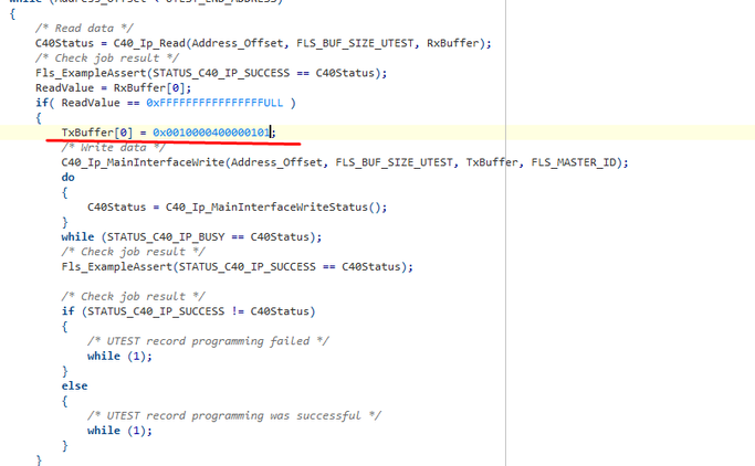

The example code for UTEST programming is here:
https://community.nxp.com/t5/S32K/S32K344-Lock-step-kernel/m-p/1930030

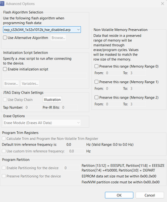

  3. Configure Debugger in S32DS:
    • Use PE Micro’s plugin to set up a debugger configuration.
    • Load the .srec file as the application.
    • Use the correct flash algorithm (e.g., nxp_s32k344_1x32x1012k_hse_disabled.arp).

And is it mandatory to use S record or can i program DCF record directly using the example program?
As UTEST is just standard flash, with OTP enabled, you can use SW to program it, like I have shared. For example C40 driver example.

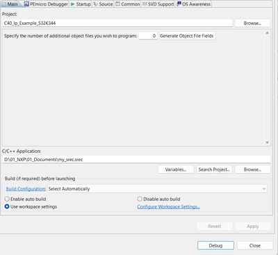

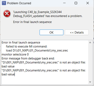

But i am unable to debug, debugging failed with .srec files.
nirmal_masilamani_2-1760347127108.pngnirmal_masilamani_2-1760347127108.pngnirmal_masilamani_3-1760347147113.pngnirmal_masilamani_3-1760347147113.png

I am confused here.
Why you are using extension srec? The debugger states that is not an object file.
When using PE Micro tools to program devices using S-record (.srec) files, the type of S-record format you use—such as S1, S2, or S3—depends on the address range of the target device's memory.

hello @petervlna ,
I have referred the below community post for debugging using .srec file.
HOWTO: Program DCF record into UTEST flash in S32 Design Studio for Power - NXP Community
.s3 extension also not working
WIth S32DS and PEMICRO,
Is there a way to program DCF record using .srec file?

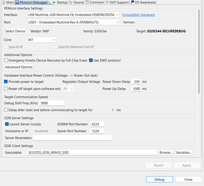

  3. Configure S32DS Debugger:
    • Create a new debug configuration in S32DS.
    • Set the .srec file as the application to load.
    • In the debugger tab, enable "Use Alternative Algorithm" and point to the correct PEMICRO flash algorithm (nxp_s32k344_1x32x980k_hse_enabled.arp).
    • Disable "Load Symbols" and "Run on Reset" since this session is only for programming.
