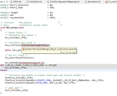

3. Iam getting multiple errrors like the parameter McuClockSettingConfig_0 could not be resolved. I did not make any changes in peripheral except for changing the LPUART5 to LPUART1 and adding couple of Dio pins
I also made sure that the Update_code is done

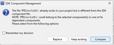

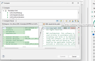

But without making any changes, when i compile the project, as per the LINStack user manual chapter 6 Known issues and limitations, I clicked "Compare" and "Copy all Non-Conflicting changes" and "commit"
i seem to get these errors:
Please advise. Thank you

Update:

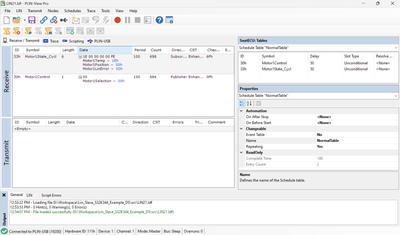

I chose "keep existing" and my code compiled successfully. I loaded the LDF file in Peak LIN and my Peak LIN reads the current motor temperature as 30 (HEX: 1E) as seen in the image.
There are specific parts in the code that seem to rise and lower temperature as shown below. How am i supposed to change the temperature / call the function. Is there any LIN command that i need to send from my Peak LIN ?

Update:
Got it figured out .
Thanks for the help @PetrS
