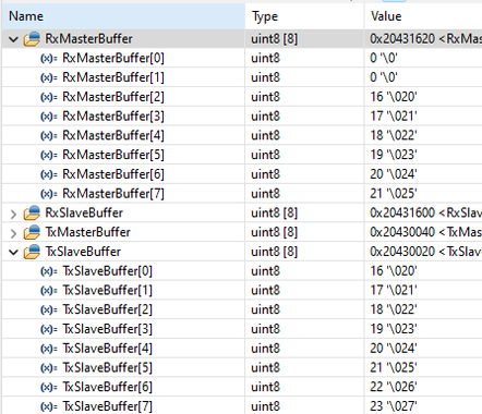

The first exchange between Master and Slave works correctly only for the SLAVE, the MASTER hasn't received correctly all the data.
After I clean the buffers, I am sending new data, but I have the same behaviours: the rx master buffer doesn't cotain all data. As I increase the data of the buffer as the lost data is increased.
Any idea?

I believe there is a misunderstanding regarding the frame size you are assigning when calling the Lpspi_Ip_UpdateFrameSize() function. This value corresponds to each data length, not the number of data items you are transmitting. According to the TxBuffers FrameSize parameter, the function Lpspi_Ip_UpdateFrameSize() should be set to 8 instead of the 32 you are currently assigning.
Regarding your code, since the issue seems to be only from the master, I made a test by disconnecting the Slave pins and connecting the Master pins in a hardware loopback configuration (Master output connected to Master input). Please test this modified project on your side.

Hi @VaneB,
thanks to your suggestions I have done multiple messages exchange between LSPI0 and LSPI2, full duplex and with DMA, so thanks a lot, great job!

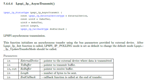

2)The API Lpspi_Ip_AsyncTransmit has as parameter Length "number of bytes to be sent", but It seems that It is used also as Rx side, not only for Tx side.
I have done an excercise where Master sends 1024 and receives 8, slave sends 8 and receives 1024, during the execution, the Master is always in BUSY status.
Any opinion on that?

Regarding your second question, as you correctly noted, the Length parameter of the Lpspi_Ip_AsyncTransmit() function is used for both transmission and reception. Therefore, if you send less data than expected to be received, the master or the slave will remain in a waiting state until all the expected data is received.
