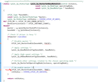

Hi ,
i am working on S32K344 board. i am trying to run Example code given for I2C
[example code: I2c_S32K344_HLD_DS]
as soon as master is enabled , Bus Busy Flag is set to 1 by driver. due to which master is always in Idle state waiting for BBF to clear. but BBF never gets cleared. master transactions are not started.
master enable happens inside this function - LpI2c_Ip_MasterSetBaudRateInit() .
tried with both pull up and down set. but no luck.
i don't have oscilloscope, somehow i am unable to confirm if SCLK is available or not.
Please let me know if i have to take care of any extra configurations.

Hi @kRekha,
According to the RM, "whenever the LPI2C is enabled, it monitors the I2C bus to detect when the I2C bus is idle (MSR[BBF]). The I2C bus is no longer considered idle if either SCL or SDA are low ..."
The bus (SDA & SCL) must read HIGH.
The example does not use the internal pull-ups on the pins.
You said you enabled it, but is it really pulled up?
Do you have a volt-meter at least?
Or you can disable the internal pull-ups and use external ones.
It is really necessary to make sure the bus is pulled up.
BR, Daniel

very first issue what I observe is : I2C Bus Busy flag is set as soon as master is enabled during I2C initialization(In baudrate init function). I am not understanding why is the bus busy flag set during initialization and it never gets cleared.
This results in Timeout .
So if we resolve bus busy issue then timeout issue will get resolved.
Can you please direct me to the solution side.
Rekha

danielmartynek
Hi Rekha,
The BBF operation is specified in the RM.
"Whenever the LPI2C is enabled, it monitors the I2C bus to detect when the I2C bus is idle (MSR[BBF]). The I2C bus is no longer considered idle if either SCL or SDA are low ..."
If you see both lines HIGH with the multimeter before the LPI2C module is enabled, then I guess the ports are not correctly muxed to the LPI2C module.
Can you check the Multiplexed Signal Configuration Registers (MSCR) just before the LPI2C module get enabled?

kRekha
Hi Daniel,
Both lines are showing 0volts before I2C module is enabled. even after i2c Init these lines voltage level is 0V.
i have configured PTC8, PTC9 for I2C0. before i2C init is done we are initializing the port pins , hence MSCR{72] memory block - 0x40290360 shows value 1, MSCR[73],  mem block - 0x40290364 is also 1. below are the configurations done on my target.
0000_0001LPI2C0_SCLLPI2C0LPI2C Clock I/OO
0000_0001LPI2C0_SDALPI2C0LPI2C Data I/OO
Rekha

danielmartynek
Hi Rekha,
The I2C lines must not read 0V before the I2C module is enabled.
You said you had external pullups on the lines.
Please double check that and make sure the lines read HIGH before the module is enabled.
