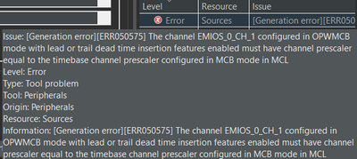

I am trying to set deadtime for a PWM.
When configuring the channel, I got this error:
What does this mean? All prescalers are set DIV_1.
Thanks!

Hi@cranes
I have reproduced the problem and reported it to the responsible team.
The response time will be very slow. Thank you for your understanding.
You can try to use the eMIOS+TRGMUX+LCU module to achieve complementary PWM output and dead time insertion.
you can take a look at this post and have a try to test the demo in the attachment.
https://community.nxp.com/t5/S32K/LCU-out-PWM/td-p/1759686

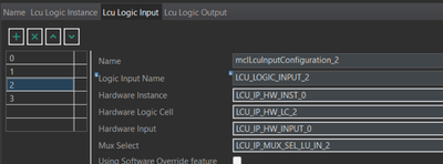

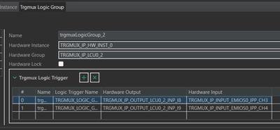

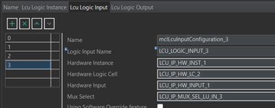

cranes
Hi Selent,
I am using LCU0 LC2 to generate another pair of PWMs coming from eMIOS0 channel 2. It works, but I still don't understand how Mux select and the value of Output LUT Control works.
Now I am trying to generate two more PWMs which come from eMIOS0 channel 3 and channle4 respectively. I use LCU0 LC2 to generate the one from eMIOS0 channel 3, but failed to generate the one from eMIOS channel 4.
If I use LCU0 LC2 another hardware input, it always generates the same PWM from eMIOS0 channel2 even I set another hardware input from LC2 as the input like this:
If I use LCU1 LC0, set eMIOS channel4 as LCU1 LC0 hardware input 0, LC0 hardware output0 as output, LCU1_out0 as output pin,  it doesn't generate anything at LCU output. Mux select is chosen as LU_IN_0. An tried different selections and got the same result.
What do you think might go wrong?
Thanks!
Crane

Senlent
Hi@cranes
I spend some time making a demo according to your setting, you can test it.
5,457件の閲覧回数
cranes
Yes, it works. Thank you!
It looks the value of Output LUT Control makes the difference.
But LCU0_9 with value 0x5555 and LCU0_11 with the value of 0x3333 don't generate anything.
Crane

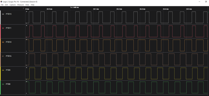

Senlent
Hi@cranes
I tested the code I sent you again, you can see the output waveform is right on myside.
so I think the demo is no problem,please double check the hardware(I'm using my own board,you can change the LCU pin according to your hardware)

5,519件の閲覧回数
Senlent
Hi@cranes
1.One logic cell can meet your needs, but you can use another logic cell which will make the calculation easier and and make it easier for you to understand the LCU module.
2.You can take a look at the Motor solution at this page.
https://www.nxp.com/design/development-boards/automotive-motor-control-solutions/s32k344-brushless-d...
AN13767->Chapter 4.2.3.3.LCU
