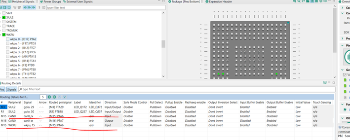

I am using S32DS 3.5 and S32K3XX RTD 4.0.0 version. I have configured an IO wake-up source using the Wkpu module.
Can you help me configure one CAN channel as a wake-up source?

Hi@YuZheng1
For example:
Also you can refer to this post, the RTD version using is RTD 2.0.0
https://community.nxp.com/t5/S32K-Knowledge-Base/S32K3-Low-Power-Management-AN-and-demos/ta-p/152772...
