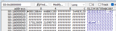

I found that I have already flagged the "Enable HSE FW Usage", the 0xAABBCCDDDDCCBBAAUL, in the UTEST.
I have a doubt: is it possible that, with this UTEST mark configured, I'm not able to install the .pink image? How could I install the HSE over the micro then?

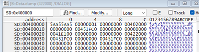

IVT at 0x400000:

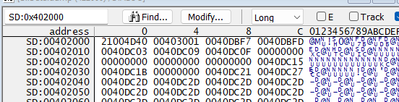

Demo app at 0x402000:
HSE Image "AB Swap" marked with 0xDB at 0x422000:
And also the UTEST:
As you can see, the HSE enable is present. However:
That means no HSE installed.
