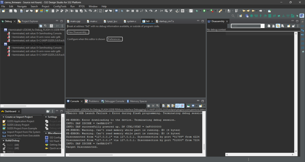

Hi, I am developing a board that has a S32K344 and a FS26. I initially added the Sbc_fs26_ip driver in the MEX configuration tool, and used the same code as the provided in the SBC_fs26_IP example project (leaving here too...), which just initializes the FS26 via SPI device.
eReturnValue = Sbc_fs26_Init(&Sbc_fs26_xConfig);
eReturnValue |= Sbc_fs26_InitDevice();
if(eReturnValue != E_OK)
    bPass = FALSE; /* Error during initialization. */
After succeeding the FS26 initialization I went back to the MEX file and enabled the watchdog, without modifying my code to add the watchdog refresh logic, so I could see the FS26 resetting the S32K344 due to lack of WD refreshing.
However, after I did this, I could no longer flash the S32K344 (leaving the debugger console log below). I am trying too to run a debug configuration in RAM instead of in flash just in case it has something to do with the FS26 resetting the device, but no luck. The only thing I can seem to do is to disable the 'Load executable' and enable the 'Attach to Running Target' in the debug configuration. This allows me to connect to the target and pause execution, BUT it seems to be stuck in a code line (unrelated to interrupts or other special feature) and clicking the Restart/Rerun button would simply go to the exact same line.
What is more strange is that this is happening with the jumper configuration set to Debug mode for the FS26 (I suspect however that this is happening because of not refreshing the WD in the first 256 ms window). I also tried to flash a simple 'Hello World' project, but I can't, and I can see the previous code being executed whenever I reset the device (I can see the S32K344 configuring the FS26 with an oscilloscope attached to the SPI lines).
I think that I could fix the problem by erasing the flash of the S32K344 so that it doesnt configure the FS26 before attaching debugger. But cant find a way to do it. Is there any other possible solution to this?

Which development board are you using?
Although the FS26 enters debug mode according to the EVB User Manual, your program will cause FS26 exit debug mode and enter normal mode.
It is recommended to disconnect the reset signal between FS26 and S32K344, and then enter debug mode to download a new program.

anertorre
Hi, @Robin_Shen Thank you very much! It looks like this made it. I just removed the 0 Ohm resistor that connects the FS26 RSTB signal  to the S32K344 RESET_b pin, and the problem was solved. Now I need to check why the FS26 keeps resetting the regulators when not in DEBUG mode, even if I disable the watchdog timer. Any ideas to know where to start from?
