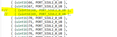

I have seen some problems in your code:

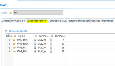

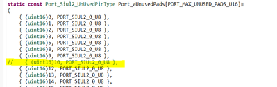

1. The JTAG pins are being left as unused, which means their mode would be overwritten and hence lead to an unexpected reset. I have to comment out them in order to successfully initialize the Port pins:
Not sure how did you do to pass it, but you can check the UntouchPin list in EB Tresos and make sure that all of the JTAG pins (4, 10, 68, 69) are untouched:

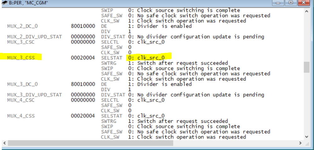

2. You expected the SYS_CLK is the CAN clock source, however in fact FIRC is the clock source for CAN (by checking MC_CGM_3):
Which means the clock source frequency is 48MHz instead of 80MHz, it leads to incorrect CAN baud-rate. Due to the fact that TJA1153 only accepts 125, 250 and 500kbps during initialization, your sending frame wasn't responded and the buffer flag wasn't set.
Please change the CAN clock reference to correct clock source, it should be FLEXCAN_PE_CLK0_2 instead of SYS_CLK:
Then re-calculate the time quanta and modify the baud-rate segments.

Hello,Thank you so much, the problem has been solved.
1.I added an unconfigured PORT.
2.The clock source was changed to FLEXCAN_PE_CLK0_2, the CAN baud rate was recalculated, and it is now OK.
When the problem occurred, I only chose an 80M McuClockReferencePoint, and did not realize the correlation between the CAN clock source and ClockMux3.
