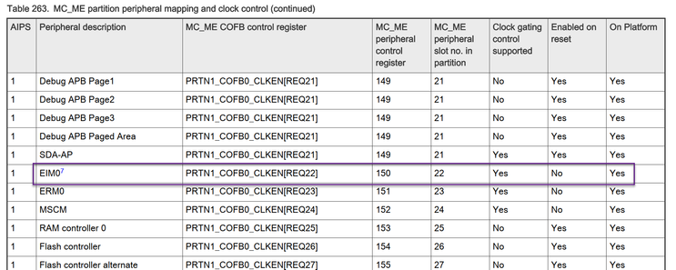

I'm currently trying to inject faults using the EIM_0 module without using the RTD.
When trying to read or write the EIM registers, the following things happen:
      (1) The MCU immediately jumps to the default handler
      (2) It's impossible to read the content of the EIM_0 registers when using the "Expression"                  table during debugging
Point (1) is generally caused by either incorrect module initialization or by not configuring the respective MC_ME register to enable clock to the module.
I already checked that REQ22 in PRTN1_COFB0_CLKEN is enabled by default, as confirmed by the STAT register, but the issue is still present. Is this register protected by default?
For context, I didn't configure the FCCU and ERM module yet.
I'm using the S32 Design Studio on a S32K3X4EVB-T172 with the S32 Debug Probe.
1,571件の閲覧回数
danielmartynek
Hi @fede_ls,
You are right.
It is this gate:
3 返答(返信)
1,602件の閲覧回数
danielmartynek
Hi @fede_ls,
Are PRTN2_COFB2_STAT[BLOCK67-BLOCK70] == 1?
This is controlled by PRTN2_COFB2_CLKEN[REQ67-REQ70].
1,576件の閲覧回数
fede_ls
Hi Daniel.
According to the Reference Manual, the PRTN2_COFB2_CLKEN/STAT registers are "Applicable for S32K328, S32K338, S32K348, S32K358, S32K388, and S43K389 only."
This is confirmed by the S32K344.h file automatically generated, which appears to end the MC_ME struct at PRTN2_COFB1.
1,572件の閲覧回数
danielmartynek
Hi @fede_ls,
You are right.
It is this gate:
