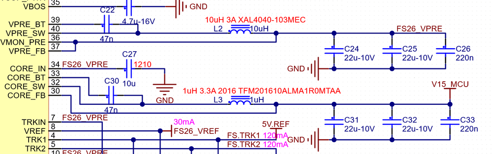

I have designed custom board with S32K344 and FS26 PMIC chip. I have used S32K3X4EVB-T172 EVAL Board as a reference.In my custom board reset pin always 160 mV. I could not managed to connect chip with J-link or I-jet. Where should I be looking for the problem? Can someone help me?

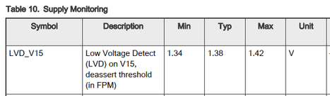

danielmartynek
Hi @mesutkilicmak,
Is the HSE_FW installed on the MCU?
Can you disconnect the reset_b from other devices on the board?
Can you measure the reset_b pin with an oscilloscope?
Is it permanently at 160mV or is it toggling?
If it is toggling, it could be becasue of the V15 voltage which is too low 1.37V.

I measured SBC output voltages. All voltages stable except 1V5. This output has sawtooth like shape.
I have MFS2613AMDA4AD chip on the circuit and 1V5 circuit is shown down below.
Is there a problem with this circuit?

Hi Mesut,
Can you share the whole schematic?
If you don't want to post it here, you can create a ticket.

Hi @mesutkilicmak,
Thank you for creating the ticket and sending the schematic.
Can you check if the MCU or the SBC is heating?
There is a possibility that the 1V5 source is 1.37V because either of the chips have been shorted and burnt.
