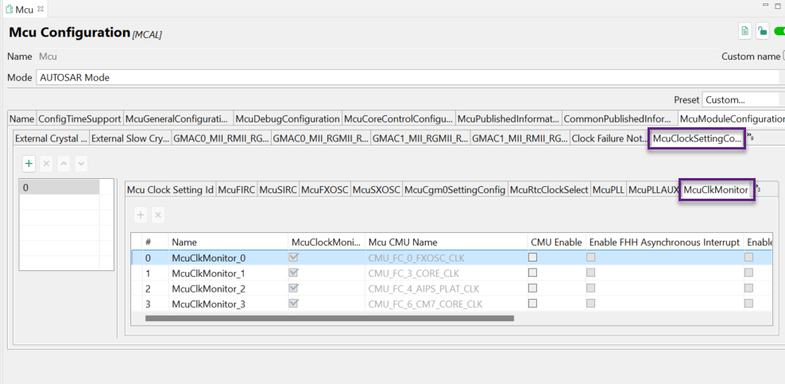

Currently, we are developing a functional safety module based on S32K344. We need to use S32DS to develop the code for the clock monitoring module. Could you provide sample files to guide the development of CMU_FC and CMU_FU

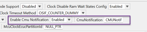

Hi @ALXY_WANG1,
Although the clock GUI has the following options (RTD 6.0.0):
the configurator does not generate code from it, so it is not supported.
