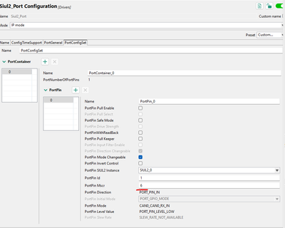

Hi NXP team,
I am trying to change FlexCAN_Ip_Example_S32K344 (in loopback mode) to work in normal mode.
In this case I do not care about Transceivers, only care about configuring CAN0_Tx, CAN0_Rx pins to work properly by connecting CAN0_Tx pin to Logic Analyzer, and also connecting CAN0_Tx and CAN0_Rx together---> The result is that I do not see any digital signal from Tx pin to Logic Analyzer, and Rxbuffer is also empty:
below is my change:
please give me help, thanks
398 Views
Senlent
Hi@Voledi
It's Christmas holiday recently, so the reply is a bit slow.

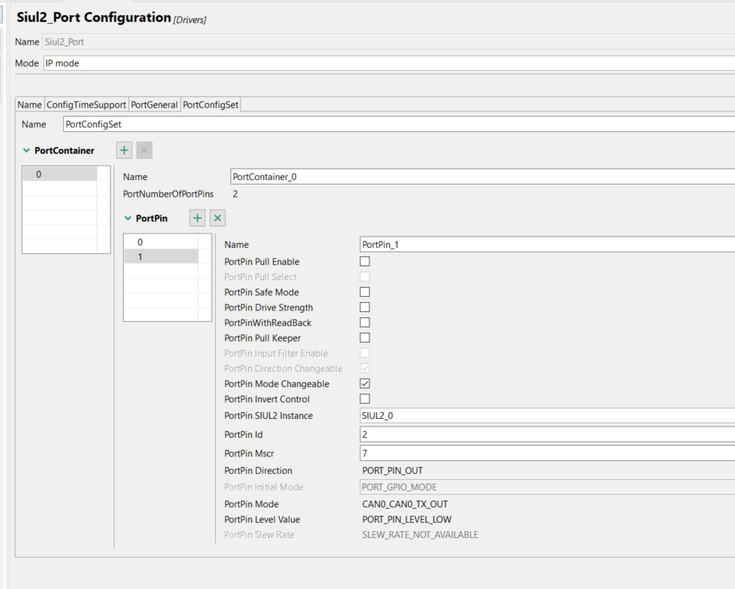

You can try adding the following pins, and then directly measure the PTA7 pin of MCU
