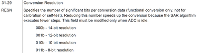

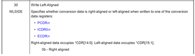

I need to know what happens regarding the data alignment of the ADC. I have done some tests and I've seen that in order to get the adc data from the regirster I have to consider the alignment AND the bit resolution in order to do the correct mask+shifting in order to get the data.
I've also noticed that if I set the resolution to 8 bit I get some data in the non-significant bits that are probably rubbish and they are not related to the ADC data.

Here it seems that the data are shifted according to the selected resolution.

davidtosenovjan
Or you may see it otherwise.
RM says that data in the result registers are always 15-bit (although I am not sure why it is stated because user cannot choose 15-bit resolution, only 14-bit)
Right-aligned data occupies *CDR[14:0],
Left-aligned data occupies *CDR[15:1].
For right aligned and
14 bit - 0 bits disappear from right
12 bit - 2 bits disappear from right
8 bit - 6 bits disappear from right
For left aligned and
14 bit - 2 bits (i.e. 16-14) disappear from right
12 bit - 4 bits disappear from right
8 bit - 8 bits disappear from right
If you application cannot use it in this format, you will have to perform shifts SW way or use different alignment.

Hello @davidtosenovjan . Thank you for your reply.
The thing is that when I'm selecting right align the LSB are not cut. For example:
My settings are 12bits resolution + right aligned. After the ADC conversion the MSB (11th bit) of the result is located at bit 13 of the register like the image bellow and not at bit 11 of the register as the alignment settings suggest.
and in order to get the adc data I have to shift them right 3 times in the firmware.

3,406 Views
davidtosenovjan
It is expected. Result is displayed always with maximum resolution. In case resolution is smaller, then LSB bits are cut (considering right align). With left align it is the same, but from left side.
